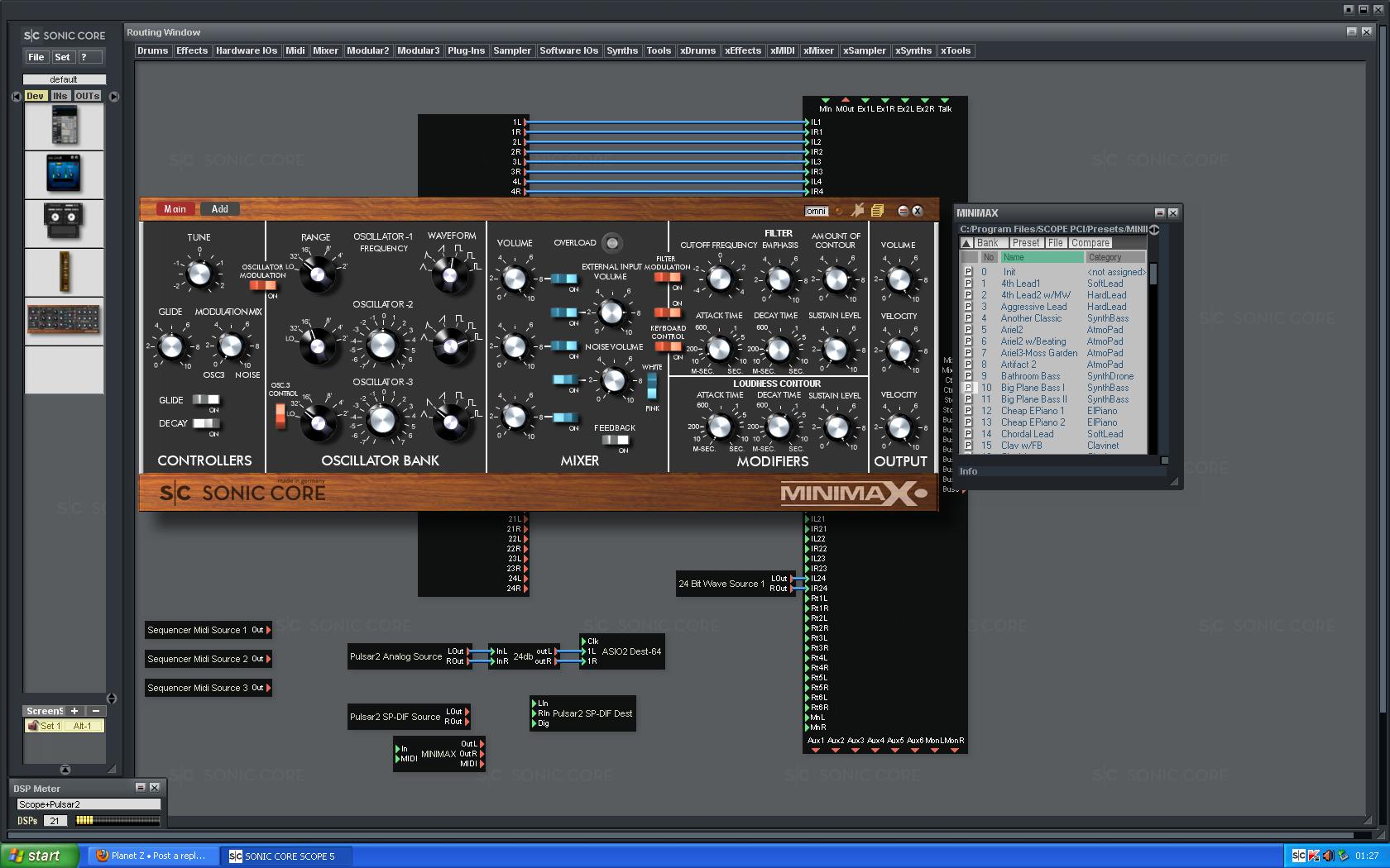

Scope presets have nothing to do with wrappers, fxbs or anything. Each device has its own preset list, see below:
This is Minimax with its preset list to the right of the main GUI. In Cubase you would just enter "10" into the Inspector on a MIDI track. Cubase doesn't know what Program 10 is, that depends on the presets you have stored in Scope. Scope presets are stored in their own folder with the extension .pre - forget the VST paradigm, Scope is its own universe that will happily integrate with almost any host sequencer.

Massive pictures BTW :P
