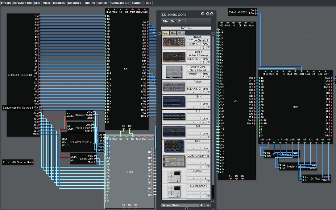

"all bus sends "off dsp" - This brilliant Idea! 24 ch stereo fully worked. Lot of plugins e.t.c., All dsp on stem is "ON", no dsp assigment.
- pro.jpg (131.54 KiB) Viewed 2946 times

Re: New AUX Mixers
Also I found some "packing algorithm" for asio projects:
from sourse to dest
1 load asio source -48 mono (24 stereo)
2 load channel module1 ( any, on the choice)
3 connect them
4 load channel mod2
5 connect to asio source and ch.mod.1
6 load stem 247
7 connect to channels
8 load master bus
9 connect to stem , xite outs, asio dest.
all worked good.

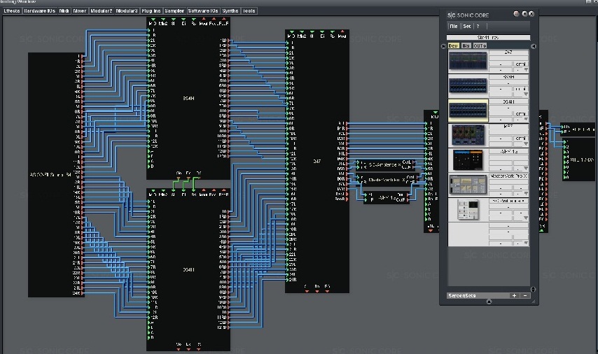

it works for instruments, too. i created fully worked project with modular mixer and instruments = 20 voise polyphony, 3 reverbs, 20 asio channels'
as I wrote - from source to dest., step by step connected.
first load instruments and asio sourse.
- 20poly.jpg (235.03 KiB) Viewed 2910 times
