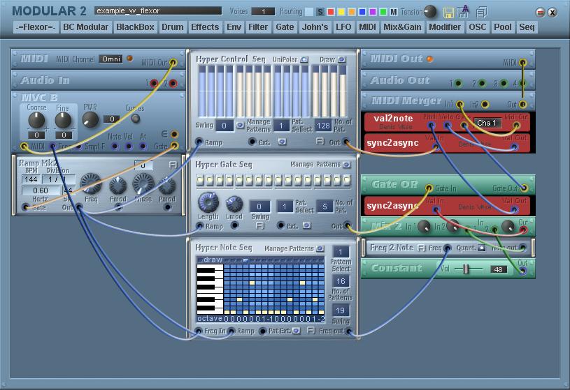

There is even a tutorial device called example_w_flexor on how to do
I tried using Hyper Note Seq rather than a Hyper Control but with no luck yet.
dunno what to plug in Freq-In of the Not Seq (tried constants but couldn't give any relevant value for the pitch to be correctly rendered).
Any hints?
Any hints?
Re: Modular tutorials
Tried to modify the tutorial with that.
Still, some notes don't seem to be well synchronized when looped.
- This one is close but not accurate enough
- #090826_MidiMod.JPG (87.67 KiB) Viewed 2126 times

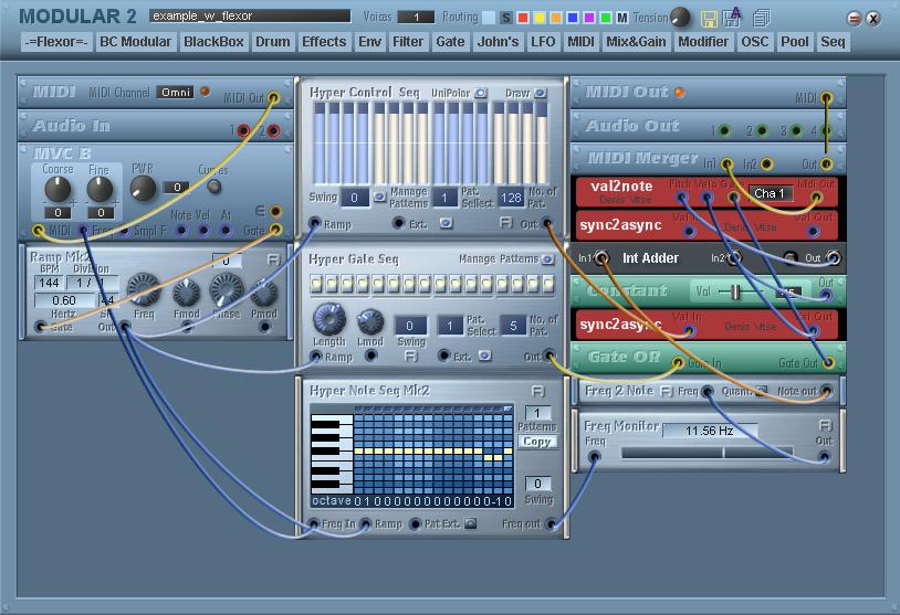

This one looks promising.
I made a change with mixer instead of Int Add for constant.
Hyper Note classic because of pattern switching.
Also, I switched on quantizing in Freq 2 Note and deleted Freq Monitor (which seemed to pose the accuracy pb).
- #090826_MidiMod2.JPG (87.25 KiB) Viewed 2120 times
