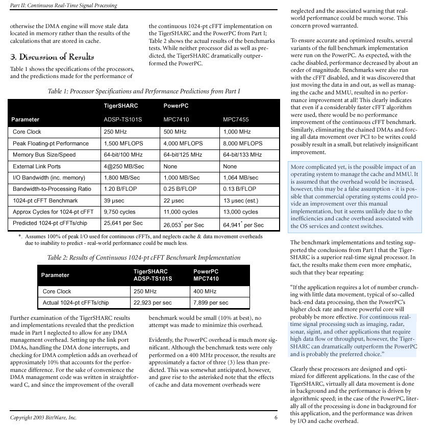

I've made a screenshot of the results page of the afforementioned TigerSharc versus PPC G4 comparison. The tests were performed on dedicated processor-boards with a handwritten 'operating system', so just the FFT task and memory and IO management were running.
Even if these processors are different from what we typically use they can be assumed as valid 'prototypes' representing their class.

Hmmm - you can make tests that shows what ever you want them to show. Tigersharcs have a wonderfull memory system, several DMA channels - alot of bandwidth. But no support for 64bit - I could make a test that shows how many 2nd order butterworth filters with a cutoff freq of 0.5Hz could each processor handle - the PPC have native support for 64bit, but the Tigersharc doesn't - you will then have to use some tricks to get the same precision and that would use cycles.astroman wrote:I've made a screenshot of the results page of the afforementioned TigerSharc versus PPC G4 comparison. The tests were performed on dedicated processor-boards with a handwritten 'operating system', so just the FFT task and memory and IO management were running.
That document is from 2003 - alot of things have changed on the CPU side, but not much have changed on the DSP side - more and more people are infact using FPGA's instead of DSPs. No matter which high-end DSP you choose it would fail in any test against the new generation of CPU's except price. It's hard to beat a price of 32 dollars for a 2GFLOPS DSP.

of course you can... I only posted the results pageWarp69 wrote: ...Hmmm - you can make tests that shows what ever you want them to show.
the company that did the test sells both kind of boards - some with DSPs, some with CPUs
as you can see in the paragraph about applications, music isn't even mentioned, but radar, ultrasound etc.
The 'test' was done to point out the specific strength of each architecture to give customers some decision support. There is no bias whatsoever in the paper.
I had some concerns about the 'age', too...That document is from 2003 - alot of things have changed on the CPU side, but not much have changed on the DSP side ...
but then it's the only comparison I know that goes into such detail of each architecture.
And regardless of what has changed with CPUs their argument of feeding data still holds.
We're not talking about a quadcore with a custom realtime OS, but a chip running either M$ or Apple's general purpose stuff.
I use Macs for decades, so I have a pretty good comparison for real world results from M68K, PPC and Intel CoreDuo CPUs, ranging from 8 MHZ to 2.5 GHZ clocks.
OSX itself must eat up a significant portion of the available resources, otherwise I couldn't explain the relatively small difference in overall reaction of the machines compared to a 500MHZ PPC with a 66 MHZ bus and SD-Ram.
As in the DSP versus CPU comparison there is a huge gap between my expectations and the realworld result I experience every day.
Imho there are countless people raving about the power of these CPUs, but noone ever tells you how the data gets into the core(s).
You may have noticed (in the article above) that the actual processing of the FFT didn't influence the PPC's result at all. The performance was entirely determined by memory transfer and cache handling
by pure reasoning I tend to assume that it may not be relevant at all for audio processing - but then there's the everyday office experience where a machine with supposedly 6 times the processing power 'feels' barely twice as fast...
