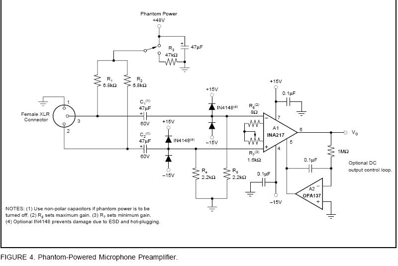

it looks like it was not too complicated to make one of them. any schematics and part lists out there? just for curiosity...
Re: Mic preamps - can YOU hear the $$$$ difference? (with audio)
Kylie, the circuit was a simplified version of the one for a phantom-powered mic preamp in the datasheet for the Texas Instruments INA217 chip.

There's more info on the implementation here >> giant killing $5 mic preamp its secrets revealed
