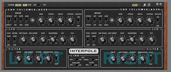

Did you see that Moog Multimode VCF (they never made one actuallly, MOOG™ I mean)
Nice GUI, follows the Moog Voyager RME design and layout.
Althought Interpole may be just as good :P

jep, thats one of the tools i would really like to try out.
on the other hand we have interpole and minimax which has an audio input also. :)
