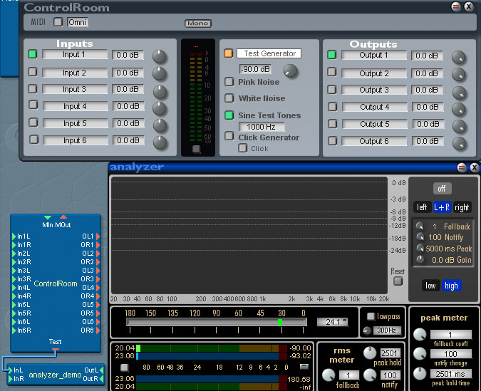

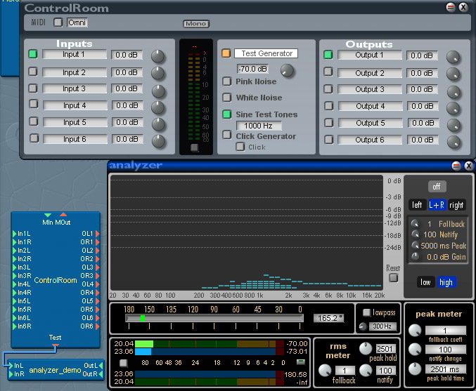

- -70db
- _70.jpg (123.72 KiB) Viewed 2919 times
- -90db
- _90.jpg (121.18 KiB) Viewed 2919 times
I'm shure if we'd meet in person, we'd have a great chat, maybe play some music together and would leave in peaceful condition.You are free to think what you want about me or anything else as i'm too
This depends on what you want to achieve with themmanu wrote:Are my test 100% ok ? yes or no ?
