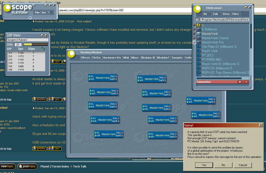

Something has happened to my system. I could need some help in figuring out what's up.voidar wrote:Upgraded my system with a Scope Pro. I now have 27 DSPvoidar wrote:Ok, an update. I can load 17 Masterverbs on this system in 44.1KHz now, lowest ULLI.voidar wrote:Asus P4P800 SE
P4 3.0GHz
2 GB RAM
Pulsar 2 classic + Pulsar 2 XTC = 12 DSP
.. running on 1 STDM-cable.
I get DSP capacity limit on loading the 17th M.verb, which is what you expecet when reading of the DSP meter.
The DSP meter is actually peaking, showing last LED as red. The 18th Materverb thus gives me a "DSP limit reached" error.
I did a lot of cleaning up. Also set highest PCI setting for both cards in DoubleDawg.
I also re-set the STDM cable, hooking the cards up with socket 1 and 3..
I finally get PCI limit at 19th Msterverb instance.
I can also load 5 STW P100 vers without problems.
Also the system feels faster somewhat running of the Scope hardware.
I can only load 13 Masterverbs now, and only two STW reverbs.
I would suspect a lot having changed. Various software I have installed and removed, but I didn't notice any strange behavour until a week ago. I haven't been doing much music production lately.
Only thing I have by Adobe is Acrobat Reader, though it has probably been updating itself, or at least by my consent.
Care to shed some light on this Neutron?
I guess I'll have to do some clean-up. Though any tips would be wonderful. I really hate reinstalling

Ok, I've slaughtered whatever suspect application I could find. I also remember I had automatic updater on for awhile, getting all the new jizz (IE7 etc), which I have now uninstalled.
But to no avail.
Only now I discover this is not a PCI-overflow error at all. This leeds me to wonder whether I've got some hardware failure :/.. But I don't get it, as SFP clearly shows detects 27 chips.
Ideas?

- Error.jpg (302.65 KiB) Viewed 5400 times
I've tried reseating, but to no avail.
I can use all my DSPs by loading a s**tload of different plugins, but when loading Masteverbs it seem like none of the DSPs on board #2 are touched.
I've found some inspiration in this thread:
http://www.planetz.com/phpBB2/viewtopic ... city+limit
To my knowledge I've got three options:
1. Experiment with board id (6+15+6, 6+6+15)
2. Aquire more STDM-cables (ordered)
3. Move plugins to biggest card.
4. Completely deinstall/reinstall of SFP/SDK (SDK might have corrupted my SFP).
I do remember starting to get STDM-connection errors some time back. I suspect this is related to everything else.
I don't know why though as the system was working perfectly. Highly efficient actually.
