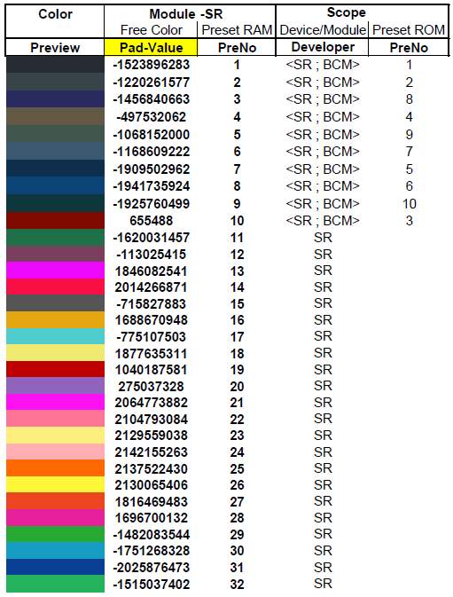

Label3a |MODULES #Spielraum
Label3a free
# easy Label module
+cascade engine
+today, my B-day, and i want to give you presents
#Tutorial: how work the Textstring Engine
connect the lightblue Module Pad "Strg" with other SR-modules with this TextEngine (cascade)
Now press the button "Write Mode" when you will send/receive Textstring.
the last activated button will send his Textstring to the connected modules.
after activate all "Write Mode" buttons, you can write in one module and will see the result in "mirror"-module
(this engine is also for future module but you can try it now in your MODULAR shell.)
#Tutorial: how work the Color Presetbank
select a preset: click on the red number, hold mouse and move up/down
you can save your own Color in up to 32 User Presets
connect the white Module Pad "Free Color" with a Fader, Knob e.g.
now select a Preset and see the color value.
move the controller and find your favorite color, or tipp in the value in a connected Textfader! (see FreeColorChart-SR-20221224a2.pdf)
is the result in your Presetbank, the Presetnumber [1~32] will show.
is the result not in your Presetbank, it will show [X]
Now press the button "Write Color", the Preset logic ist activ!
select your final Presetnumber and send with yor connected Controller your Color Value!
Repress "Write Color", for permanent save!
You can all Presets change in realtime when "Write Color" is activ
finally, combine other SR-modules with this ColorEngine (cascade)
#Free Color Sheet
# easy Label module
+cascade engine
#Free Color Sheet
