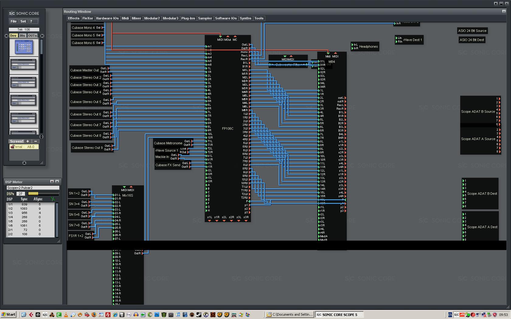

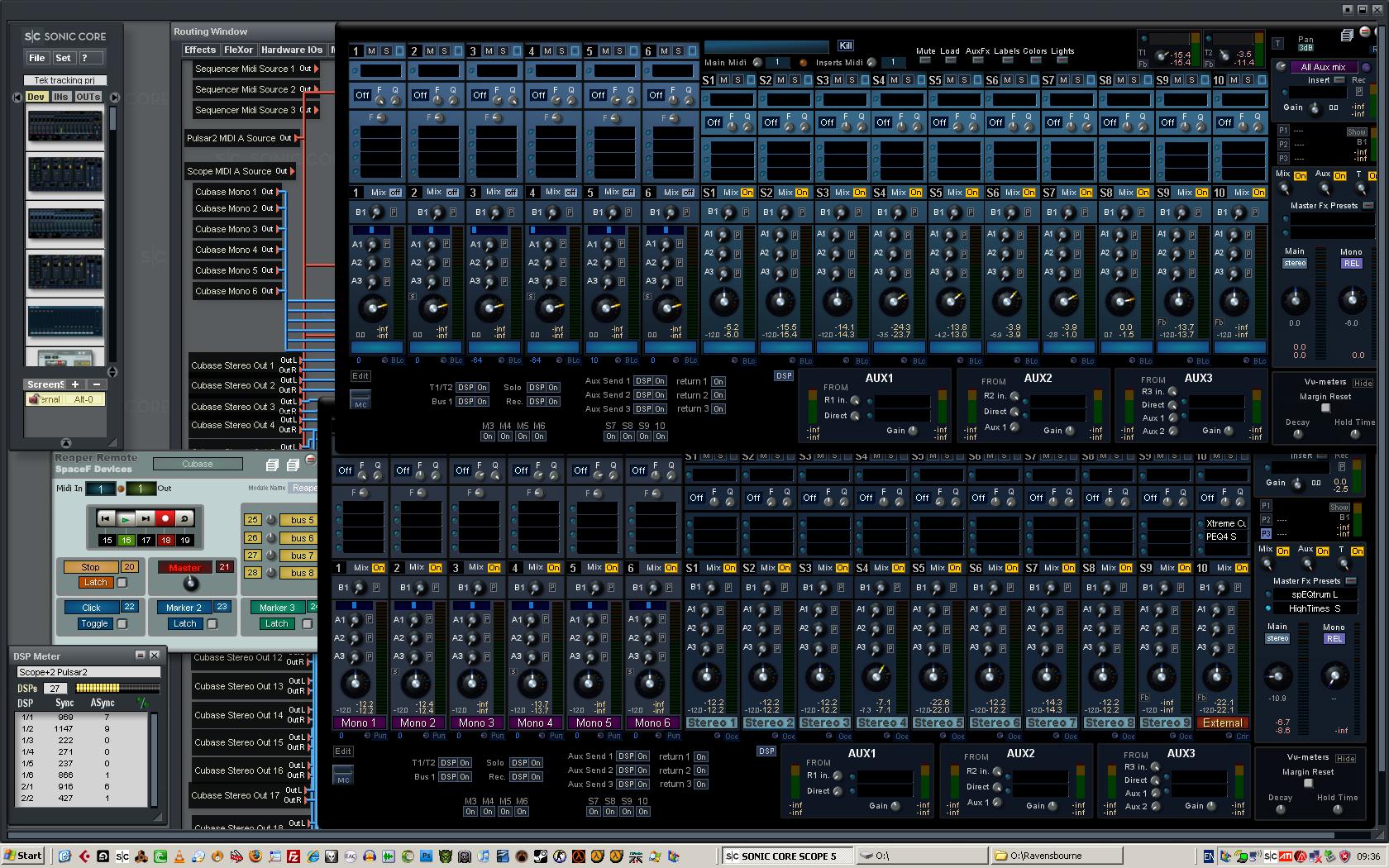

Has anyone found an issue with scope 5 resolution. On my system it doesn't display correctly at 1680*1050 so spacef fb series mixers are not fully displayed.
Also I have a bit of a graphics anomaly with a black bar that runs below the screen and is viewable when scrolling in the routing window. Minor grips though this is a nice upgrade but won't be running it on my music partition just yet.
black bar visible when scrolling down
Scope 5 graphics anomaly.JPG (225.1 KiB) Viewed 4552 times
the mixers have to overlap to fit on screen
Scope 5 res.JPG (391.95 KiB) Viewed 4552 times
