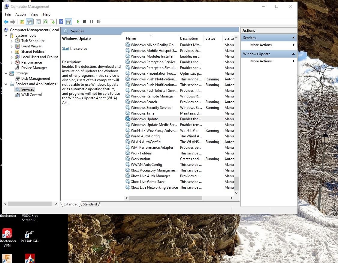

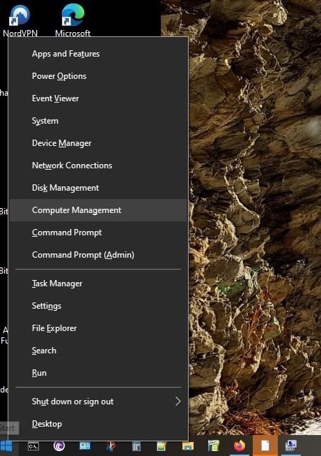

right click the start button, choose computer management from the menu.
on left go to services
scroll to bottom of list and look for service name "windows update"

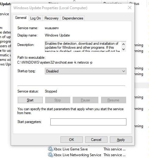

right click it and choost stop.
right click it and choose properties.
change the startup type to disabled
Liquid EDGE
Posts: 1205
Location: Brighton England
Re: How to optimize windows 10 for Scope to avoid clicks and pops!?
Post by Liquid EDGE »
One
Liquid EDGE
Posts: 1205
Two
Liquid EDGE
Posts: 1205
Three
