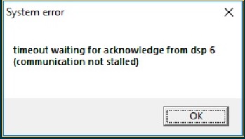

dante wrote: Thu Dec 07, 2017 10:22 am INITIALLY RESOLVED BY SCOPE7 XITE RE-INSTALL BUT RETURNED AFTER REBOOT.
NOW RESOVED BY USING AN OLDER SCOPE INSTALL WITH NEW INSTALLED OVER THE TOP
Scope 7 Plug In : None (Startup). Warning only.
OS : Win 10.0 x64 - Fresh install on clean SSD drive
HW : Scope XITE-1D
CPU: i7 4790 (not overclocked)
MB: Asus Z87
RAM: 16GB
ULLI : 12ms
Sample Rate : 96KHz
Reproduce: Start up Scope XITE
Once this error is acknowledged with a mouse click Scope starts and behaves normally - eg this error seems to be a warning only.
DSP6 timeout error
DSP6 timeout error
Note: This error does not occur using XITE-1D under Win8 (on the same system). Nor does it occur using Scope PCI under Windows 10 (again on the same system). So it seems specific to Scope XITE-1D under Windows 10.
Now - heres the wierd part - Booted under Win10 but running the Scope 7 from the Win 8 partition, the error does NOT occur !!!
