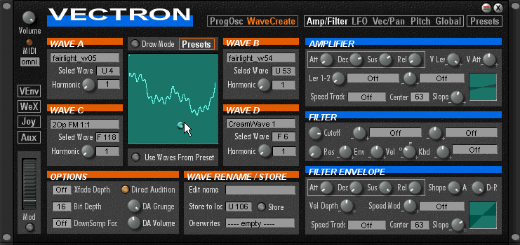

next to nothing wrote:However most of the magic is done in the ProgOsc Section when it comes to sound design after the presets are loaded as you show here. You will need to select the wave from the dropdown menu within ProgOsc. When you select waves within wavecreate, you can morph between up to 4 waves (as you show) to create a new waveform that can be saved in a new user slot.
Ok heres lesson 2 then based on that :
vectron lesson 2 - making own waveform and mixing it with others

once you have loaded the wave preset file then you can use them in the
program osc page one you have created presets using any of the wave data that is loaded in the wave create screen
you then save these to program .pre data which is seperate from the wave data .pre file
so wave data .pre are just the waves
preset data .pre is patches for the vectron that uses the internal waves and user waves
and contain all synth params that you have created from the synth its self
and this is where all the sound magic happens
the wavecreate .pre data file is your sound pallete where you get your paint from like colours each waveform is a different colour of sound
and the program page is your canvas where you mix and paint your scenary in sound sense you add your colours waves and mix and filter and modulate to create textures of coloured sound and these are your created patches works of art that stand for other to admire in the sound gallery

But the waves used are stored with the preset, and become PreA, PreB etc, so they are always there for the preset to use.
