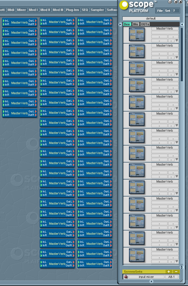

Had to retest because I have a new setup:
I have an ASUS motherboard 1.9 gigahertz with a lot of RAM and an ATI Radeon. Windows XP service pack 2 with updates.
Pulsar II + Luna (9 DSP chips)
I can load 5 masterverbs.
It is curious to me that I can also load 5 masterverb pros.

I can do that with 2 Pulsar Ones on a PIII, strange - I would have estimated 7 or 8.On 2006-08-30 20:45, braincell wrote:

ASUS P4P800SE
3GHz Intel
4GB RAM Samsung
Matrox Dualhead
2 Sata Raptor 74GB (fastest ive ever seen)
chieftech dragon + 450W supply
5 fans blowing in 3 out of case not all connected with the suply (depends on the weather 'temperature')
Liteon DVDwriter
Pulsar 1 , Pulsar 2 , SRB 1 (The one with 4DSPs) = 14DSPs
1 stdmcable
P2 + SRB on own IRQ
Pulsar 1 sharing IRQ with USB2.0 ex
all USB, Lan and Onboard Sound Active !! (use it as talkback)
TV/Video active
plane project = 9 MasterVerbs PCImessage on the 10th while whatching the news with the TVcard;
only XP pro (SP2) tweaking is to disable all windows sounds;
if you need more than max 3 masterverbs on one project forget the project
good vibes from vienna

setup i built for a good friend:
ASUS P4P800SE
3GB prescot //EDIT sorry GHz
2GB ram samsung
2 HDs SATA (raptor 74GB)
matrox dualhead
liteon dvd writer
case chieftech dragon 450W supply
2 fans 1 blowing in one outz
1 scope professional / 1 scope project = 20(21) dsps
connected with 2 stdm cables
scope prof in slot 2
project in slot 4
no irq sharing
default bios settings exept:
onboard AUdio disabled
all other things (LAN . . .) active
win XP pro; nuendo;wavlab;scope45;neroburning;
NO Tweaking!! ( no standart pc things or so .. .)
12 Masterverbs message on the 13!
i post this becourse i think its a very good combination for those who want to make no tweakings just plug and play;
stable with good performance

Our new 14 dsp booster arrived from Creamware today. Just installed it in a system with a 6 dsp project & 3 dsp powersampler (23 dsp total) & ran a Masterverb test as per Alfonso's instructions (blank project, just load as many MVs as possible) .... result ? 60, yes 60 MVs without an error !!!!! I decided to stop because I was getting bored & a bit worried that it might blow up
I won't list the full system spec, because it's the same as the system I used in the MV test I did earlier in this thread (Asus A7N8X deluxe with both network controllers & all other unnecessary hardware disabled in bios)
I'm wondering if it's actually working properly
Edit:- These results were false. The system was momentarily brain-dead & allowed me to just keep loading MV's. I'll leave the picture of 60 MV's loaded so that we can dream
- 60_MVs_no_error.jpg (727.81 KiB) Viewed 10064 times
