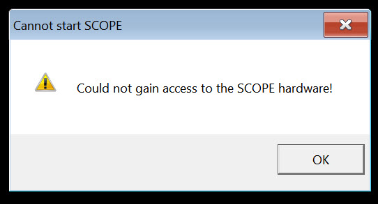

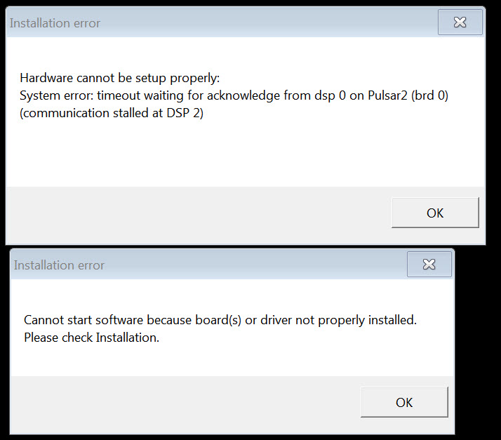

I did notice, when I went to remove the small board, to clean the contacts, that one of the four plastic screws had the head missing, but the other side was fine. No problems I can see on that one either. I decided to give it one more try and this is what I get:

The first message I get is "Pulsar2 (board 0) not found". Then the above screens.
The drivers reinstall no problem. Separately and with a full Scope V.5 reinstall. The reinstall is a hassle because I have to recreate my screens and delete anything Pulsar to work. On the bright side, it's one less IRQ to deal with!
