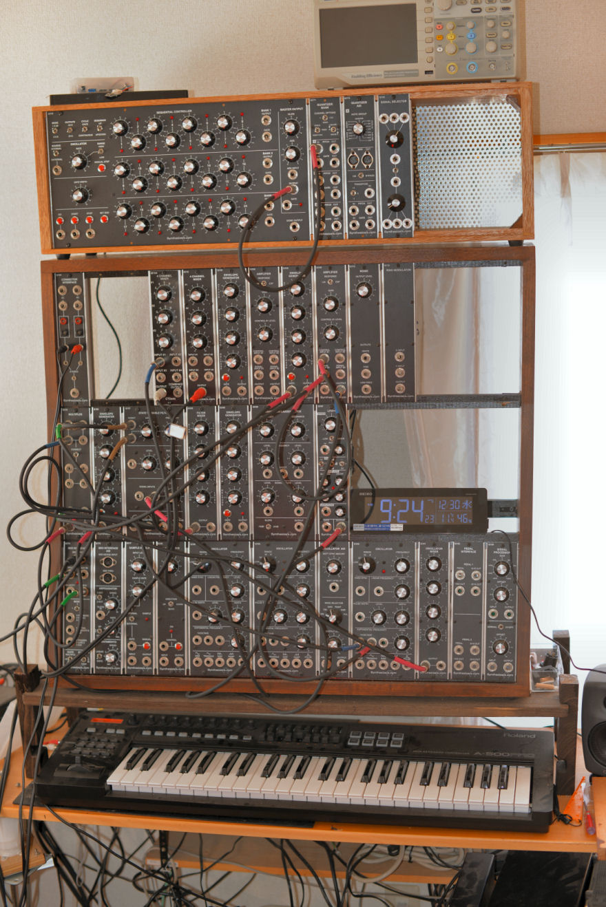

My modular synth has switchable ranges from -5 to +5V or 0 to 10V. The other ranges are the supply voltages, which are normally not used directly as CV.
It is guaranteed in my system, that no voltage exceeds these limits. SO you can mix audio and control signals without fear off overloading.
You have a choice of input-type (linear or exponential) for most of the modules (VCO,VCF or VCA). Also EG exist, which accept CV as inputs (i.e. definition of A,D, S or R).
With modular synths, yes, space is an issue, but actually no risk.
WOK (wall of knobs): (all cases were designed and built by me)

Bet that synth is a FAT Basrard.

JoPo wrote::) Excellent ! And with some Scope analog I/O and Silent Way, you can make your hardware modular synth play with Scope and vst's ! That must be terrific !
Even better: imagine an OSC Client (Bela IO) sitting on top of the Synth having 8 analog outs for CV. That's one of my next projects.
And yes, it's FAT. I even haven't tried with my KPA stack (Kemper KPA+Yamaha 1300W monitor).

looks like the granddad of fat Bastards!! :D ..nice rig DragonSF

ShogunSpy wrote:looks like the granddad of fat Bastards!! :D ..nice rig DragonSF
Thanks. You should see my guitar rig!

wow man nice rack!!!!
