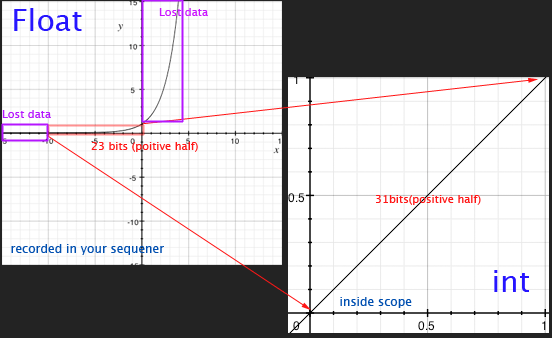

ReD_MuZe
Posts: 670
Joined: Sat Jun 15, 2002 4:00 pm
Re: Another thread about summing in scope
Post by ReD_MuZe »
yes, but float is not from -1 to 1. you have a given headroom.
take scope for instance - you are getting the slight rounding error you are talking about, not with 32bit float, but with 40bit float.
the mixer atoms in scope for instance have extra headroom that gets clipped (lost) when converted back to 32bit integer.
to test this do the following: take a mix3 and tune all the gains to max. and connect the following:
in1 : maximized drumloop
in2 : maximized drumloop
in3 : -maximized drumloop
you will get the loop without any clipping. if you want to make sure there is no folding taking place, you can make a filter out of it ;)
what i have seen is that you proove that if float 32float can have rougly the same resolution as 32int, providing they have the same range used for audio. and thats obvious they have the same amount of 0 and 1 combinations.
but they don't use the same range for audio.
data is getting lost. about 8 bits.
last paragraph here:
http://www.dspguide.com/ch4/4.htm
and in simple forums english:
http://www.gearslutz.com/board/masterin ... float.html
where does the extra headroom go in 32bit integer? this is the question to answer.

ReD_MuZe
Posts: 670
Post by ReD_MuZe »
yes we are getting closer finally :P
of course exponent is signed (bi polar) otherwise you wouldn't have ANY way to represent numbers smaller than 1 :P thats not the issue. the question is how much precision do you retain by converting 32bit single precision float to 32int signed.
yes we have lost anything above 0 in the exp value which is exactly like loosing an entire bit (which kills your earlier argument just buy itself, since now we can only use 31 bits of info, and we have half the resolution just because of that. (+ - 2^30)), but thats not all because now you need to compute also the small numbers, too see they don't crunch into integer. since integer cannot reach the ultra low numbers float can produce. so my questions what happens to this range :
floating point range:
(1 / (2^23)) * (2^(-127)) = 7.00649232 * (10^-46)
to
to(1 / (2^23)) * (2^(-8)) = 4.65661287 * (10^-10)
this is the lowest number in fractional 32bit integer:
1 / (2^31) = 4.65661287 * (10^-10)
everything under that is lost as-well.
edit:
thats 5 bits, leaving us with only 2 bits of exponent for 23bits of data.
considering rounding errors, reduces about 1 more bit of precision (half)
http://en.wikipedia.org/wiki/Floating_point
here the second paragraph reads:
The advantage of floating-point representation over fixed-point (and integer) representation is that it can support a much wider range of values. For example, a fixed-point representation that has seven decimal digits, with the decimal point assumed to be positioned after the fifth digit, can represent the numbers 12345.67, 8765.43, 123.00, and so on, whereas a floating-point representation (such as the IEEE 754 decimal32 format) with seven decimal digits could in addition represent 1.234567, 123456.7, 0.00001234567, 1234567000000000, and so on. The floating-point format needs slightly more storage (to encode the position of the radix point), so when stored in the same space, floating-point numbers achieve their greater range at the expense of slightly less precision.
and ofcourse of you look here:
http://en.wikipedia.org/wiki/Single_precision
Single precision binary floating-point format
* Sign bit: 1
* Exponent width: 8
* Significant precision: 23 (24 implicit)
afaik there is no way on earth to get the same resolution from two different ranges of the same bit depths.
pure logic - no math.

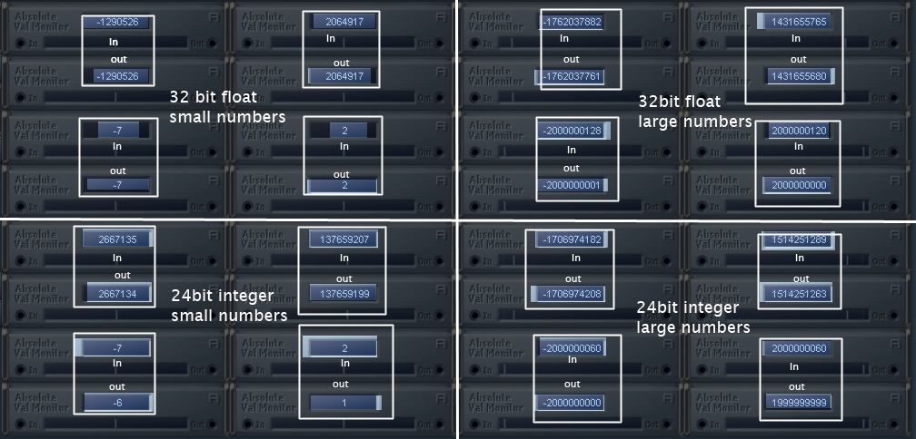

Post by voidar »
Just did an experiment here using REAPER and Flexors Absolute Val Monitor.
Trying both ASIO2 32 and FLT drivers, I pass an absolute value from Scope through REAPER and back to Scope into a different monitor.
I discovered that the FLT driver holds greater precision at lower values (follows same value up to a specific point) than the 32 driver does, which is basically a value or two off the whole range. Closest to VDAT.
This seems to be support what Warp69 is telling us.
According to the designer, REAPER takes any ASIO driver format, but internally converts it to a 64-bit float value.
Even VDAT, though the most accurate, has a slight offset it seems. Probably some gain-staging.

simple.
becouse 24bits has slightly better error correction at the top end.
look at this pic:
32bits float are better for silence (the stuff you don't hear) and teh difference between 24bits and 32bits is just by one point.
when you go to the high range (the stuff you actualy hear) 24 bits is on the upper hand with a nicer rounding algorithm that makes rounding errors of + - 64 points while 32bit float reaches errors of 128points.
both have the same precision and different rounding algos. this is the experiment i did on reaper. comparing 32bit float drivers and 24bit integer drivers.

and here is a graph roughly explaining why this happens:
not that the zoom and selection size on the float side is not correct but in order to it being correct i would have to select sub pixels. so it just gives the idea across.

Knowing weather or not it is best to use FLT ASIO drivers is important to me and has seemingly gone completely uncovered. It seems to me to be a very fundamental question that almost all users of the scope environment can benefit from, if even just by a few rounding errors.
my experiment shows that both 24bits and 32bit float have the same resolution after conversion, but the rounding is different.
while you get more accuracy on the quiet parts of 32bit float, you get less accuracy on the loud parts. its a give and take situation.
i think you cant tell the difference anyhow, and it all gets converted to 64bit float inside the daw anyhow.
so to answer your question - if you are recording through converters - record at 24bits integer to keep exactly the same audio that got into the card. if you are recording a synth - record in 32bits float - to keep your sound as much in tact as you can (well it gets quantized from 64bits anyhow.) all the rest is irrelevant.
