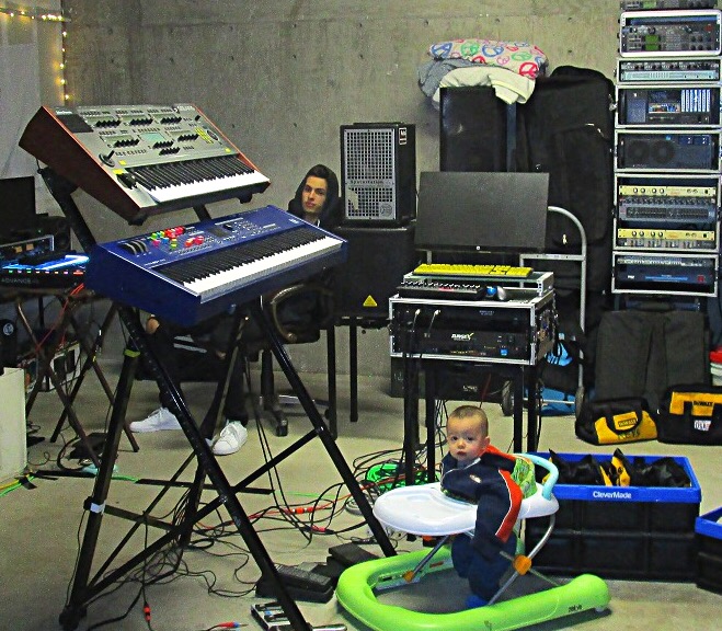

It was so weird. It didn’t shut down, itjust souded like somebody threw a few Comforters over my cabs.
But what a great build. All the local guys, mostly gamer gurus do “pretty” work but never understand my desire for low temps and real time performance.

I liked the 4790k’s so much I bought two new ones and sat in them.
Only thing I’ve changed in the last 4 years was switch from W7 to W8.1 and now W10.
And Bud the Family Room has the HTPC and Router with a 58” Samsung UHD 4K.
Down in the basement me and Scope 4 Live Jr. each need direct connections.
His 100 foot is perfect to reach his area.
I’ve got a 75 footer, but had to add an extra 10 cable to that.
It’s fun down there.
