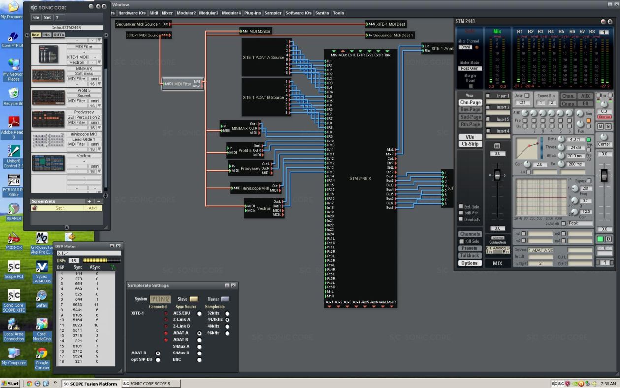

I was wondering if someone might be able to shed some light on the advantage of assigning the DSP's. I have gotten much better results just leaving them alone on the synths (haven't tried with anything else cause it's seems only the number of voices that max's out the sys) The stock synths seem to be optimized and even switch presets fast with 16 voices and no DSP assignment. (see pic#1)

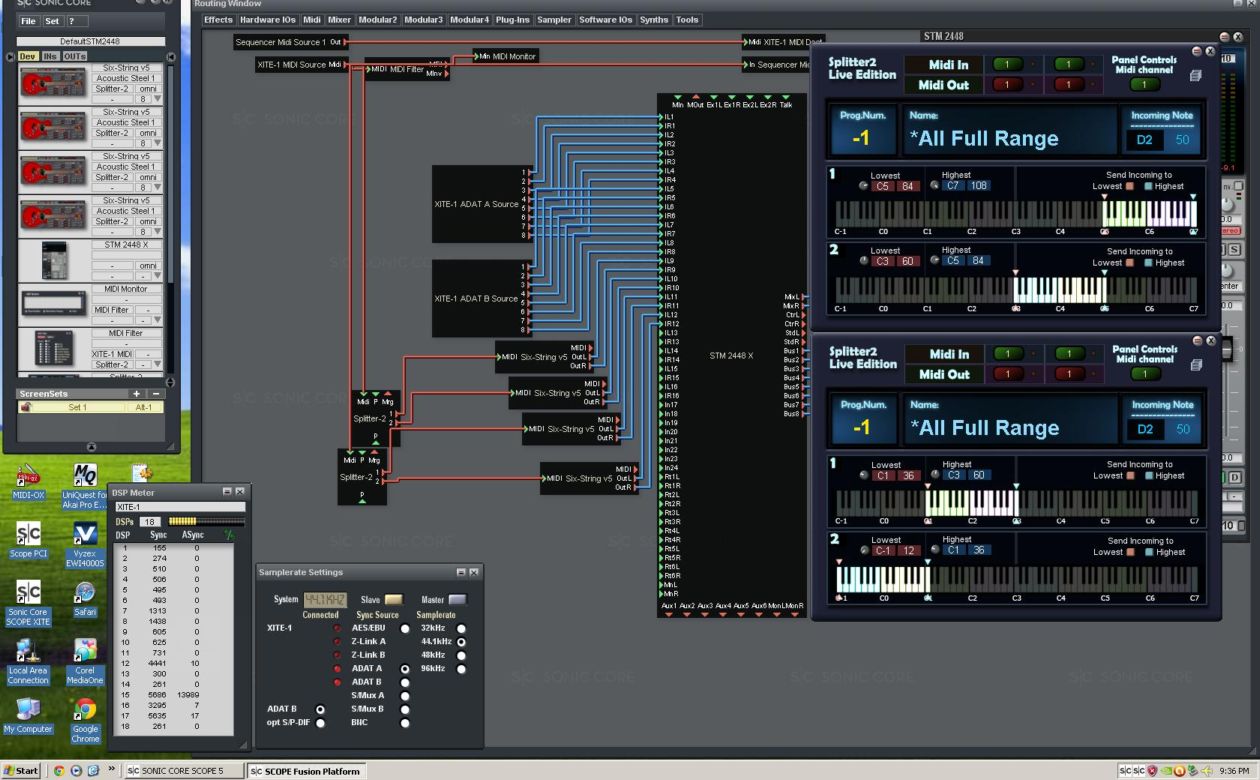

The second pic is the Void2 with no DSP assignment. (I had to step up to 13 voices from 4 voices one at a time in order to achieve this and I cannot switch presets without lowering it back to 4)

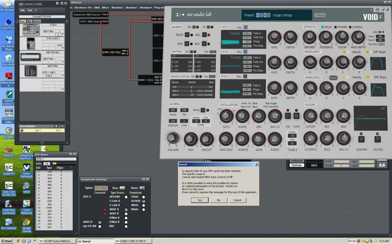

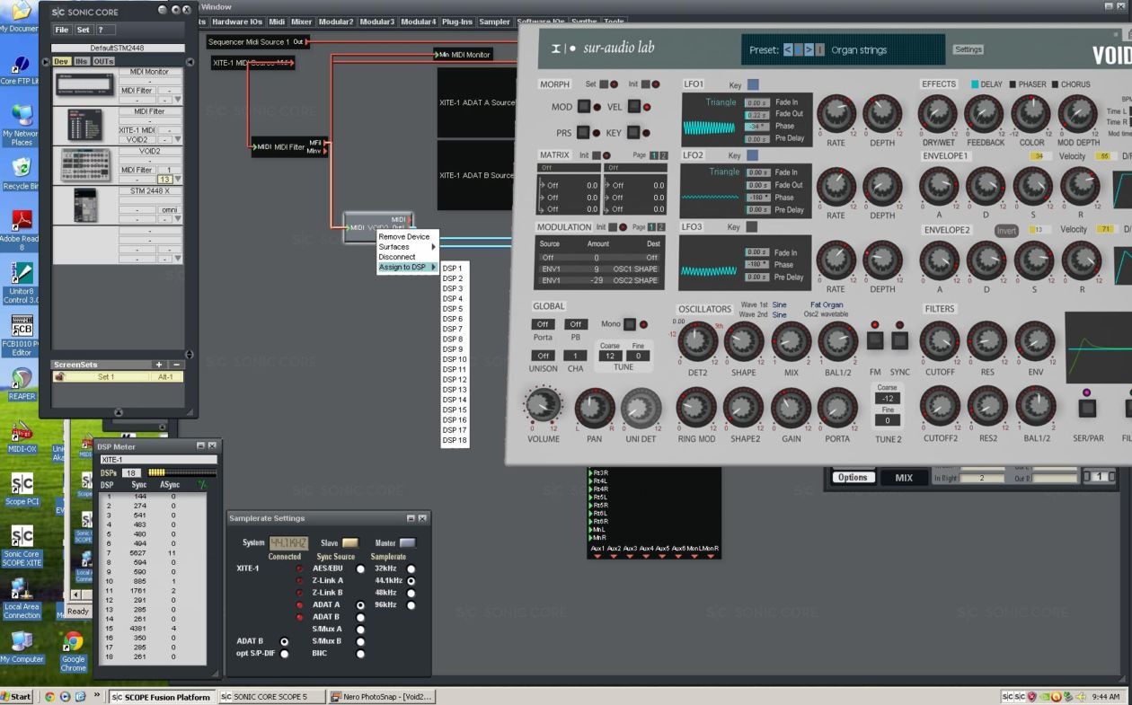

This third pic is assigned to DSP 12. I tried and got the same results with DSP 9-18

With stock devices and especially the STM2448, you shouldn't need to do anything actually.
The only advantage is once you have the Project Window with what you need, you can stick in Modular Patches w/ low default voice counts, assign them a DSP and do not clear the assignment, but leave it be and save the project.
The next time the project loads up Modular won't be fighting with other optimized devices, synths and effects.

ok i'll have to try that with the modular. What would you consider the minimum voices on a keys or string patch? I can get 8 out of Six String on the Xite but I could get 12 easily on the PCI cards (of course that ate up most of my 26 DSP's :lol: ). I'm wondering if I were to load 2 instances with a key splitter if that might help alleviate some dropped notes? Have you tried that or something similiar?
Posts: 1704
Re: DSP Assign
Well here's 32 voices of Six String thanks to Mr. SpaceF. Might be a work around to max poly on certain synths although I must admit it's a bit of overkill but who cares i like it how I like it :)
