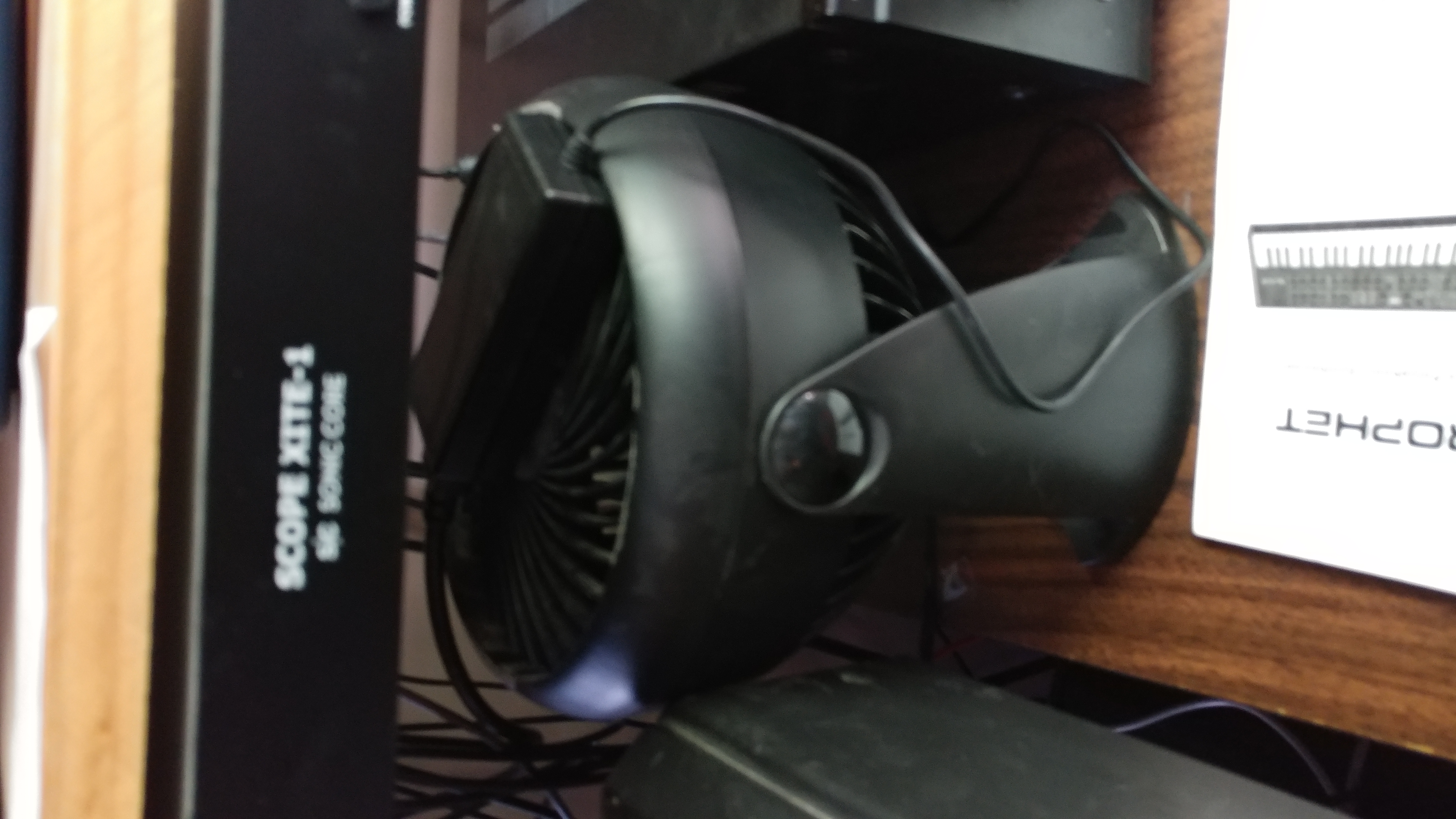

You should have stayed in TN Jimmy. It's been in the 80's all week long.....won't last though I have a feeling what's out west will eventually move this way soon.
Fan under the Xite with the pwr supply right on top of the fan. Not needed? - maybe, but long term maybe buy me a few years. I also have a big fan in the window sucking out the heat which cools the entire room dramatically.

- Xite fan.jpg (3.4 MiB) Viewed 9015 times
