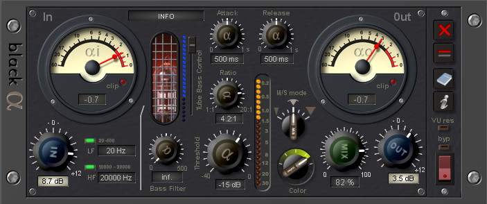

A big mistake.
The MIX Potti had no function.
This is the corrected version.
Hi
Another sounding Compressor. Placed two "Bands" on the side and middle signal.
Have fun
r
Peter
Hi
Have fun
r
Peter

One thing though ... When i tweak the m/s to the left side (mono) i seem to be getting the output panned left ....
(Does this enable processing only on the left channel ?(??) )

I can not find this problem but have another error noticed.Yogimeister wrote:Still exploring it ...
I corrected it.

Hehe thanx ... I didnt get to the stage of mixing it "out" yet ... Am still learning how to use it in 100% mixPeter4724 wrote:
I corrected it.
I will reDL and see if I can display the behavior I encountered ....
But basically - what does the m/s knob do ?
(Feeds m or s into the "sidechain" ? Or m/s control of the signal (both in and out ?)
- Peter4724
- Posts: 78
- Joined: Mon Jun 25, 2001 4:00 pm
- Location: AUSTRIA
Re: Free Compressor Black Alpha corrected
The M / S mode knob turned to the left reduces the current threshold value from the side signal.Yogimeister wrote:But basically - what does the m/s knob do ?
Right turned the threshold of the middle signal is reduced.

Does the compressor work on both bands seperately - or is there one single compression (attenuation) stage that will works on both bands (but reacts to a function of two different attenuation signal feeds?
(I couldnt understand if thats what you meant by two "bands" on m/s - or if u were referring to the bass band and the "else" band
- Peter4724
- Posts: 78
- Location: AUSTRIA
Here's the signal flow.Yogimeister wrote:Thank you
Signal input - high / low pass filter - 2-band frequency separation - M/S separation for each frequency band -
a compressor on the high and a compressor on the low for each M/S Signal.........out.

(If this is the case - may i suggest a seperate m/s control knob for high & low bands - to be able to tighten the mono image on low and expand the highs a bit
