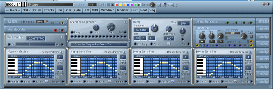

Type: Sequencer Section.
Pulsar Version: SFP 3.1
Requires: M III and FleXor
Hello,
This patch consists only of the note sequencer part, ready to be completed with your choice of oscillators, filters etc.
It derivates 4 consecutive ramps from FleXor ramp, with some math operations.
The Note seq.'s outs are connected each one on 4 inputs of the Granular seq. hooked to the "mother" ramp, that collects them in a single out for the oscillator(s).
You can connect also other flexor ramped modules, in parallel with the Hyper Note Seqs. Controllers can be mixed in a mixer.
MVC gate out is shortcut with e-sync, if you use stock CW envelopes connect them to e-sync instead.
A Value Monitor shows the progression of the mother ramp. If you don't need it you can delete it.
I hope you like it.
