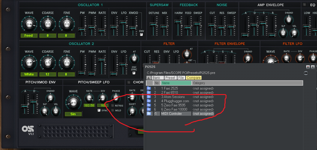

Is it possible to make presets "remember" CC# assignments?
I can right-click assign a CC# to a fader on my device, but I can't figure out how to recall it with a preset. Anyone?

In the preset browser you have a bank for midi cc assigns. do your assignments and save a preset in that bank.
