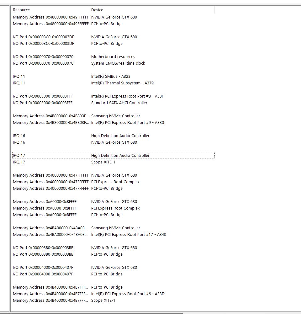

My Pc has a BSOD everytime I configure the output of a stanalone audio app to scope's ASIO,
example : any Arturia stanalone apps, Hise, Voltage Modular and Sample Robot 6 cause a BSOD
the driver on the BSOD is Scopexite.sys
This is driving me crazy, I have used driver verifier to search for conflicts and there is 1 i've disabled it in device manager,and I've tried re-installing scope, but it makes no difference
I think that maybe all these apps try to take control of the Scope driver
any thoughts on how to solve this?
