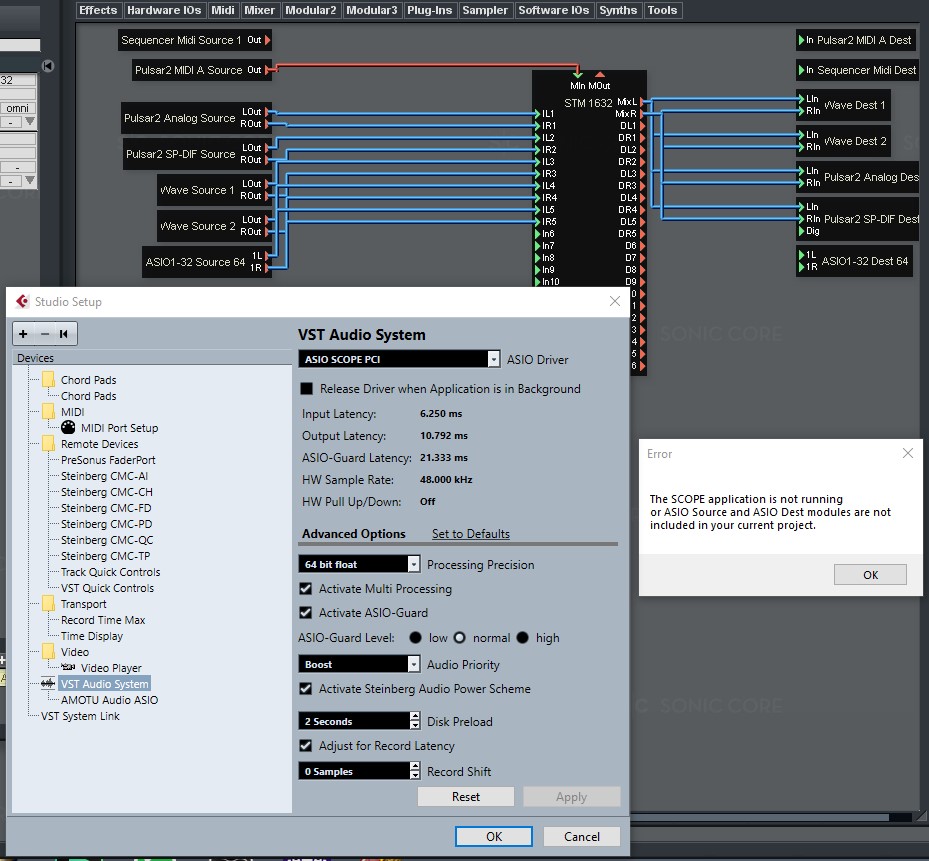

I'm a newbie here (and in Scope), a recently purchased old Pulsar II card. I installed Scope 5 (latest) 64-bit version on my Windows 10 comp.
Scope started successfully, everything works fine.
When I launch Cubase 10.5, it asks me what I want to use for ASIO and if I choose Scope ASIO, Cubase will write - "The Sope application is not running or ASIO Source and ASIO Dest modules are not included in yout current project"
Is 5.1 Scope ASIO driver working in 64 bit or is upgrade on Scope 7 required ? Or any other help ?

run Cubase in win8 compatibility mode or use Scope v7.
Posts: 7745
Re: Pulsar II ASIO not work - newbie
^^ correct, your version of Cubase is up to date for Win10, but Scope version is not. GaryB states how to resolve this.

two things i can never say enough, be sure that the ASIO source and destination modules are in the routing window with the correct number of channels BEFORE opening Cubase. also, don't allow the computer to sleep!

garyb wrote: Wed Feb 12, 2020 7:17 am two things i can never say enough, be sure that the ASIO source and destination modules are in the routing window with the correct number of channels BEFORE opening Cubase. also, don't allow the computer to sleep!
Thank You, I have that modules always open ..
With Cubase in Win8 compatibility mode works excellent.
Solved, thank You all ..
