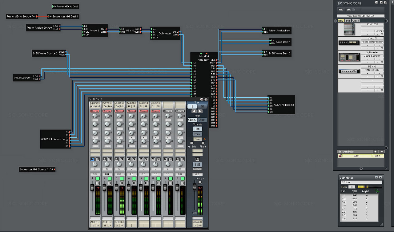

There must be something conceptually wrong in my understanding of your words Gary, because I can use wave drivers in 64 bits in Win 7. Look at this project please, the one I am posting here, I know I will be ashamed for your explanations by the end of this thread, :lol: but I want to understand what is going on, it must be something really silly. Here you have:

wave drivers do PLAY BACK in 64bit, but they do suffer random pops.
wave drivers do not RECORD in 64bit.
if you are able to record to your wave destination in 64bit, congratulations! you are probably the only person who can say that.

I almost never have pops in my play back through wave drivers, fortunately
Yes, I record into ASIO, you're right
