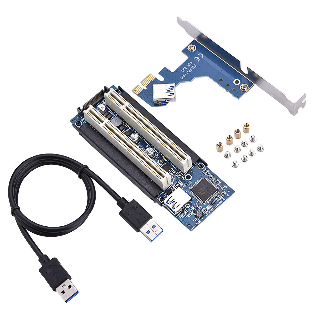

Micro ATX PCI expander
Post by fokas »
This just caught my attention. It can be Sata powered which seems promising but needs to be tested and will be an ergonomical wonder for a MicroATX in a ATX Case.

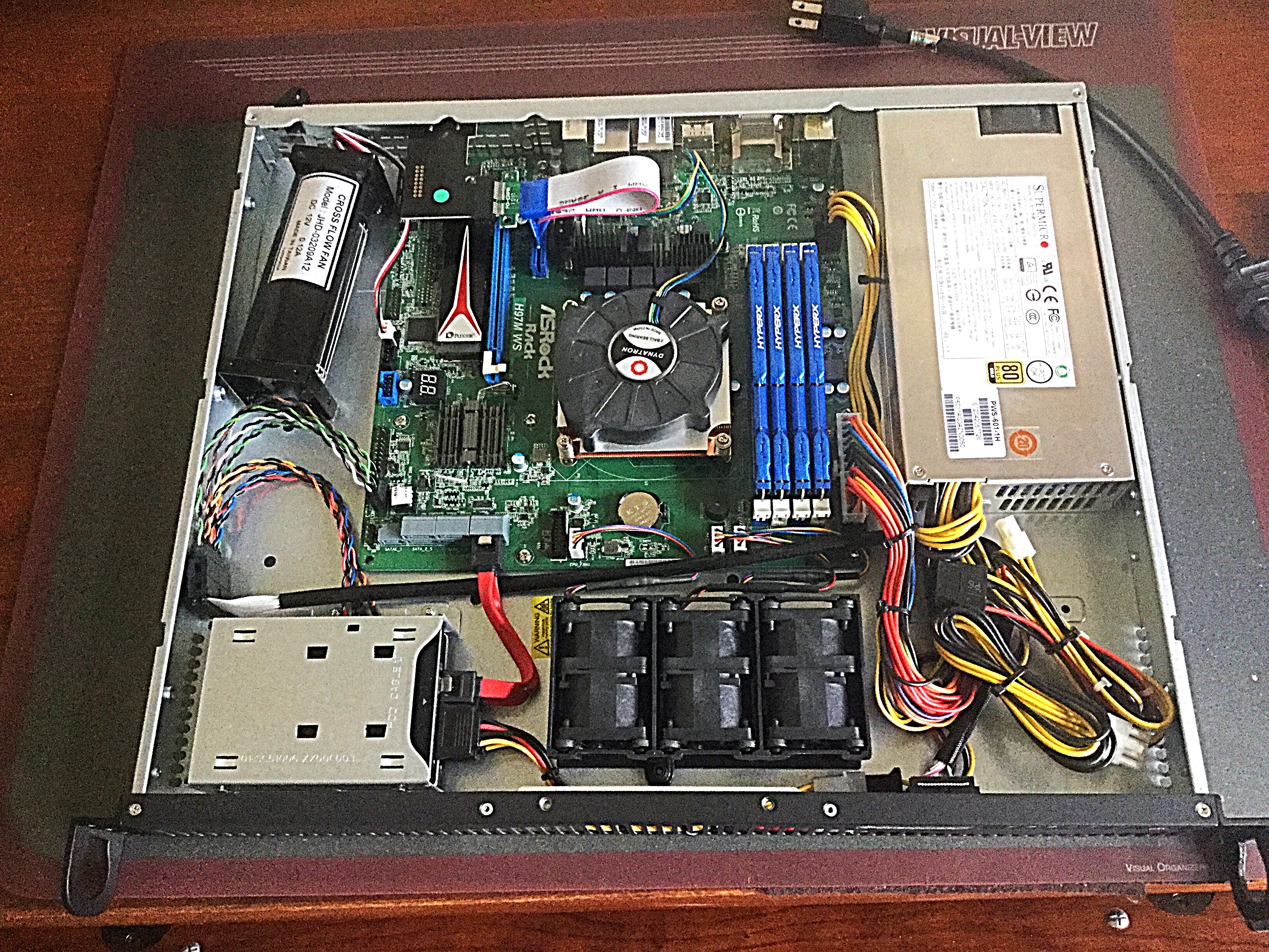

I've been using Riser Cards and Ribbons for years.
Its how I have 1U PCs for Scope.
Using micro ATX too.
We don't need all of the excess slots and gunk on gaming boards.

looks like that sintech pcie to pci riser card.
did you get it to work?
with internal and external cards?
more than 3?
Re: Micro ATX PCI expander
You need to ensure it’s the proper voltage conversion for 32 bit PCI Slots to function correctly.
But using one that would work would be a gold mine on Z97 boards.
No PCH Redirections, straight to the CPU.

so far, there have been no good expanders that i have seen.

Sure.
Supermicro CSE-512f-440B which is a 1U ATX Chassis
i7 4790k
ASRock anything Z or H97
32GBs Of DDR3 RAM
Samsung 850 Evo SSDs.
That’s about it.

wow! great! And you have a box for your scope through pciex-to-pci adapter, is it correct?
Posts: 23375
no, he has an XITE-1 which has a connector in a PCIE slot.
external PCI expansion boxes don't work well.
also, as you can see, he does not have a bunch of dsps inside there and he still needs to be aware of heat. 3 space minimum for a PCI card is a good idea.
